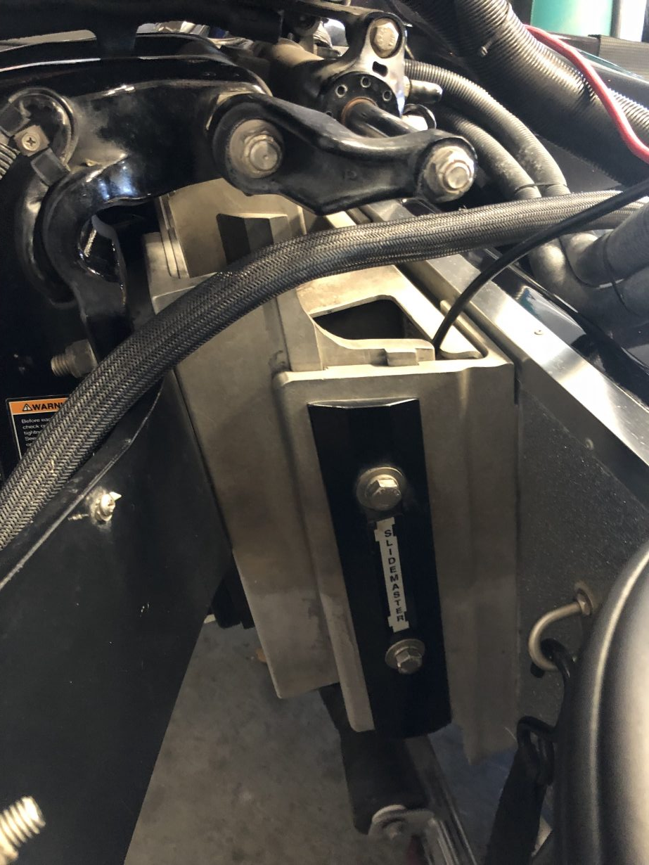

Is 3/8” above level on my jack plate too high?
Engine height is all about steering torque and water pressure. If you have steering torque to the left, you are to high. You also need to watch your water pressure, the 150 Optimax motors do not have low water pick ups, you raise the motor too high you will loose water pressure especially in turns. 3/8″ above flush is ok if you meet the parameters above

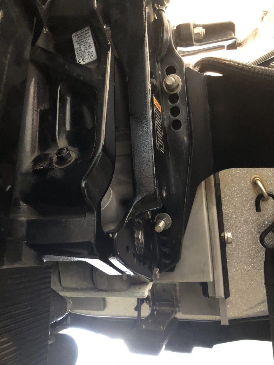

Which hole on the motor is used to mount the motor to the jack plate? There are 5 holes, mine is mounted using the second hole from the top. Everything you are describing indicates your motor is too low and you are using too much trim.
Ok I will check where the motor is mounted as soon as I can. And as far as trim, I’ve heard of over trim. How would one know if the motor is over trimmed?
Ok here is a picture of my mount and jack plate. I’m already scheduled to send my prop out for reconditioning and balancing this week. Also ordered is a new brand new torq hub and medium PVS plugs. My gear oil appears to be within normal limits.
Paul, your motor looks to be mounted in the second hole which is normal. Your jack plate setting also looks ok as long as you do not have excessive torque and water pressure is 12 PSI or above. I prefer 15 to 20 like you mentioned you are getting. As long as you are not getting too much ventilation with the large plugs coming out of the hole (it will act like the prop is slipping) then the medium plugs will reduce ventilation and possibly slow down your hole shot. It is all trial and error, every boat is different depending load. My recommendation for a person to work your prop is Ronnie Gilbert 337-380-1437. He is very knowledgeable with BassCat hulls and will know how to best tune your prop for your set up.
