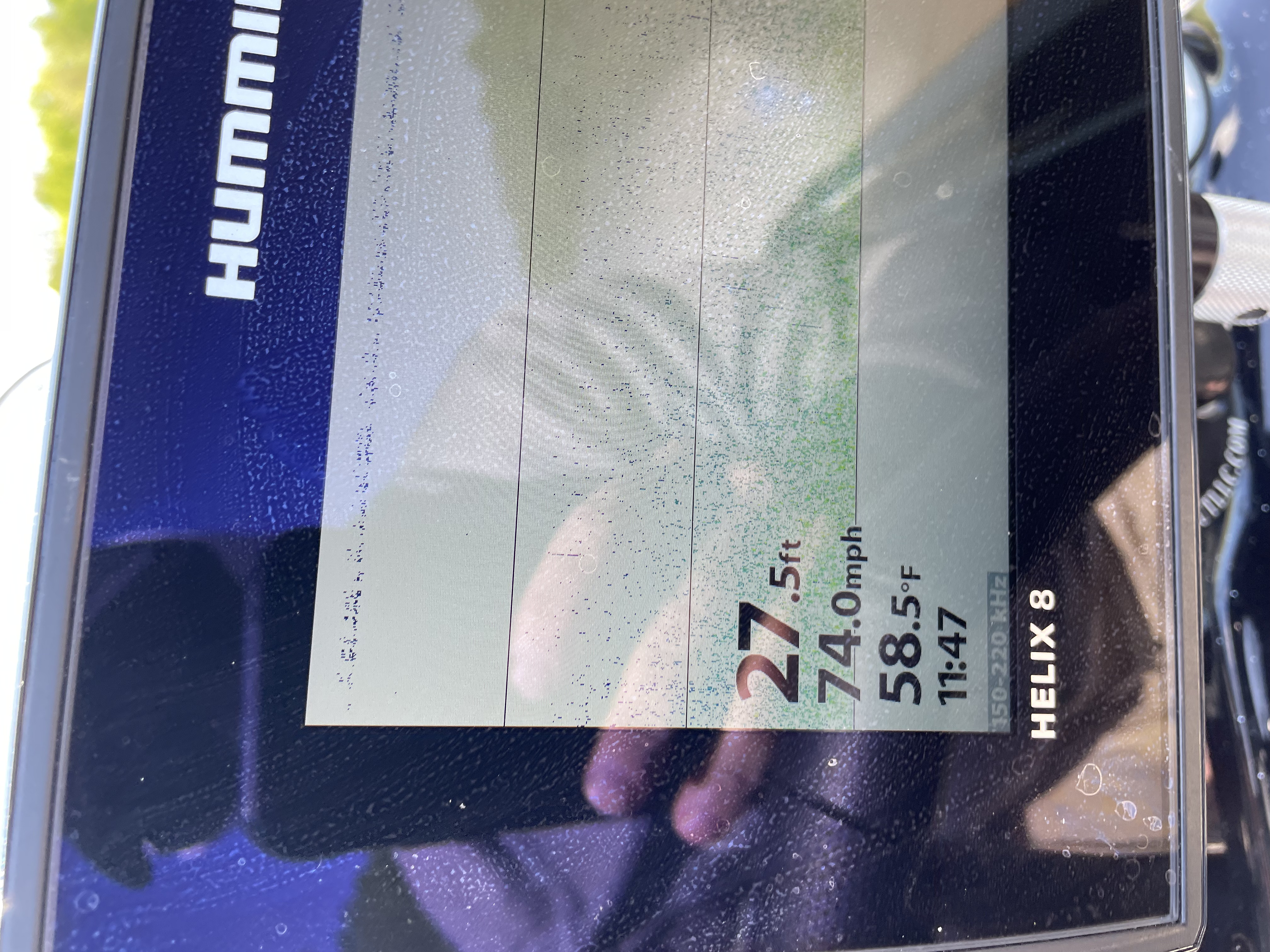

My P2 is running 74 mph consistently by myself with all my gear and 33 gallons of fuel. With the Fury 23P 3 blade..

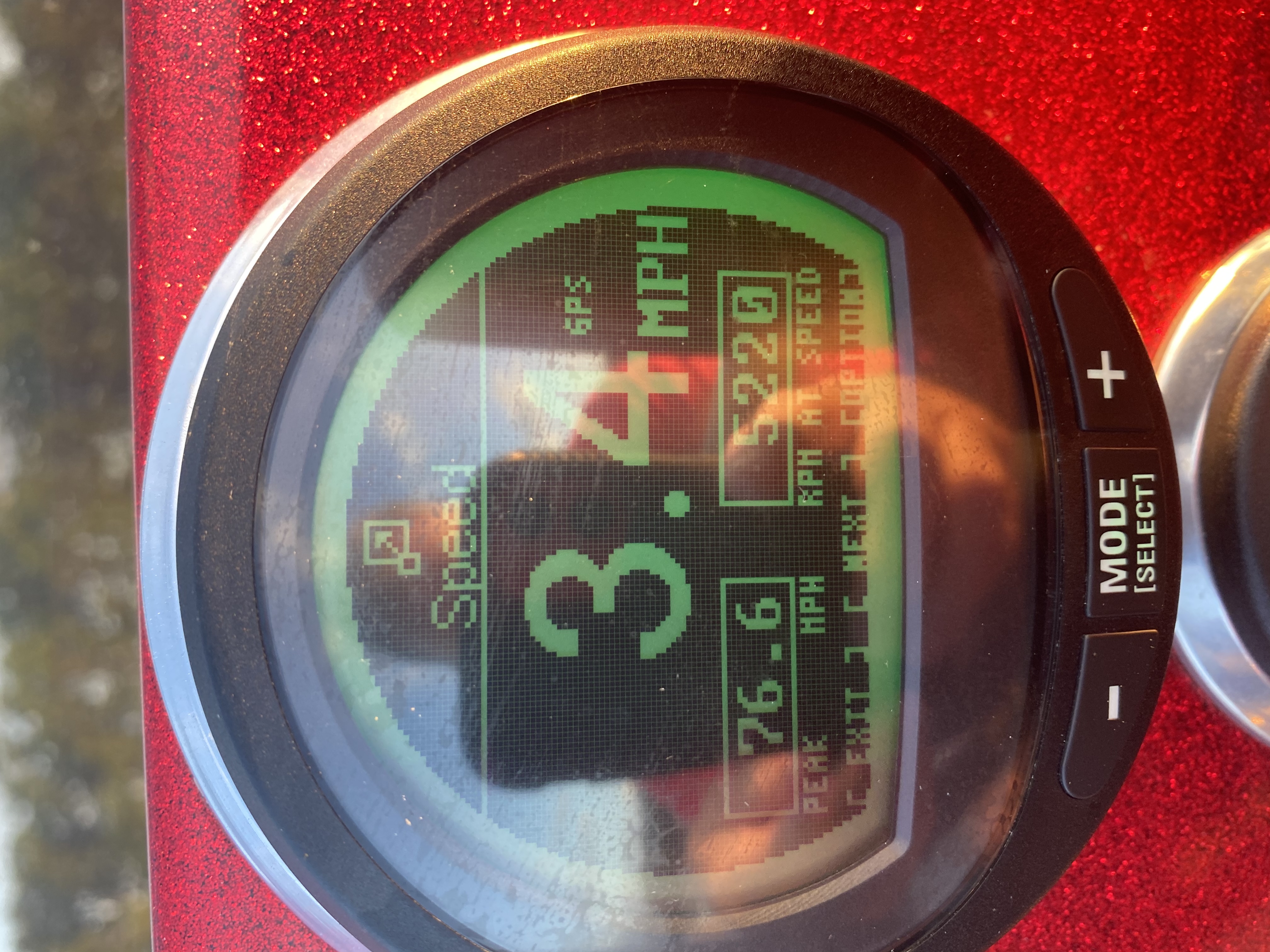

2021 P2 200 Merc Pro XS 4S with 24P Fury prop 3 blade.
My dealer had the boat to 76-77 MPH (empty boat and current may have been involved) after raising motor. However, I have not had enough time to go to big water where I can stretch her out. I still get to 70 mph easily on my short runs fully loaded…..I mean FULLY loaded (every compartment stuffed and 30-43 gallons of gas).
