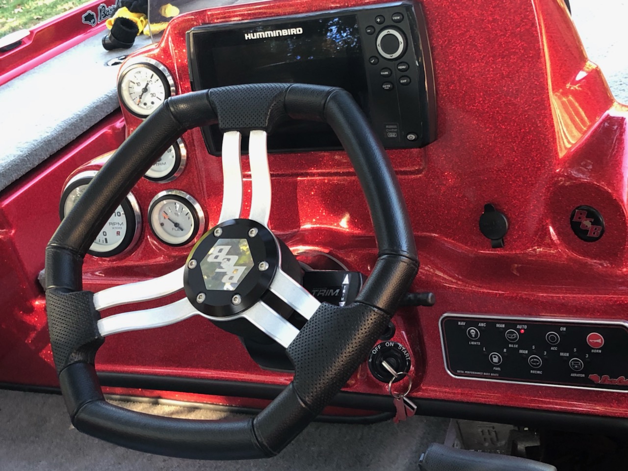

I tried a Precision Sonar mount on my 2017 Sabre and a Helix 9. I could not get the geometry of the mount, tilt steering and my legs with a hotfoot to work out correctly. The PS mount required me to tilt the wheel down which blocked my thigh/leg from getting at the hotfoot. I ended up just cutting out the console area and doing a recessed mount.
Before:
After:
This Sabre had a 175 2stroke. I found the best prop to be a 24 or 25P Trophy Plus. I plugged the PVS holes solid and did not use an exhaust ring.
