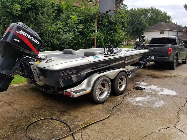

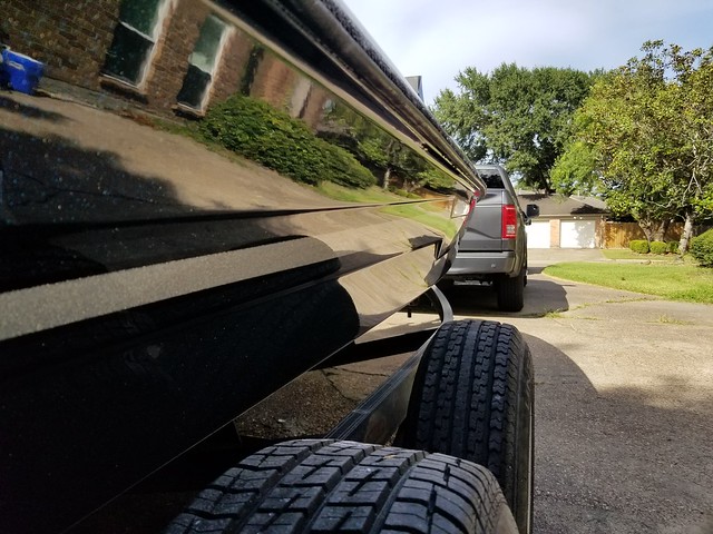

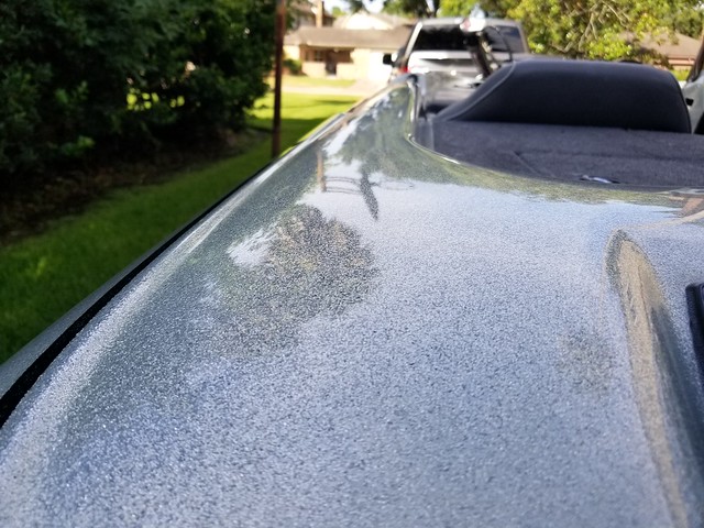

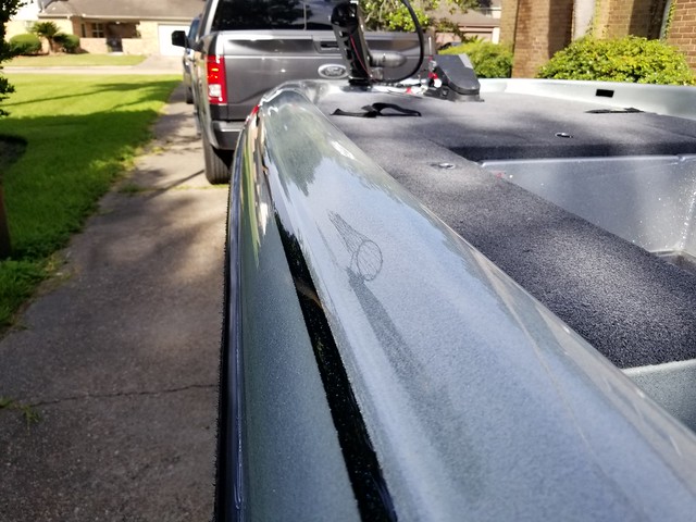

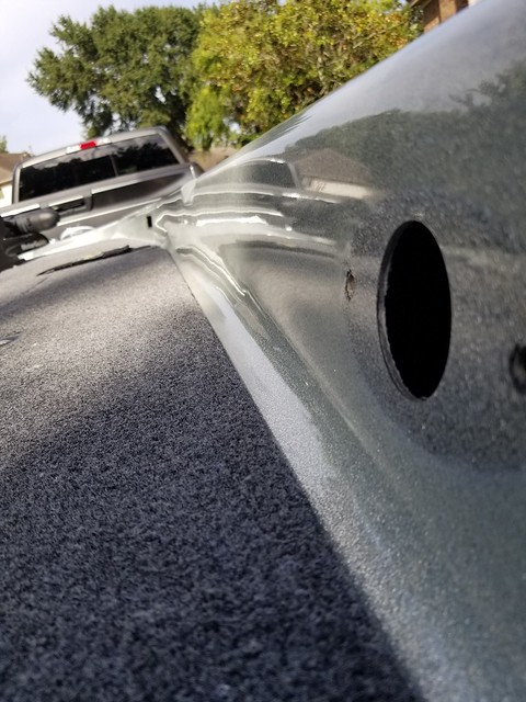

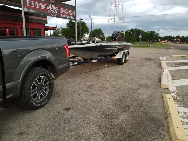

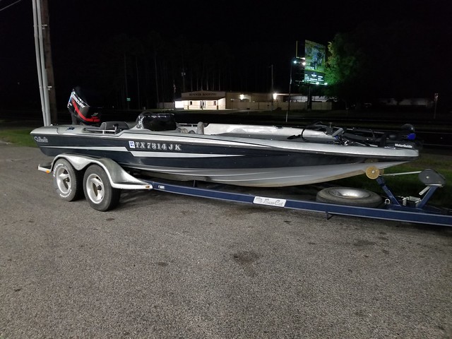

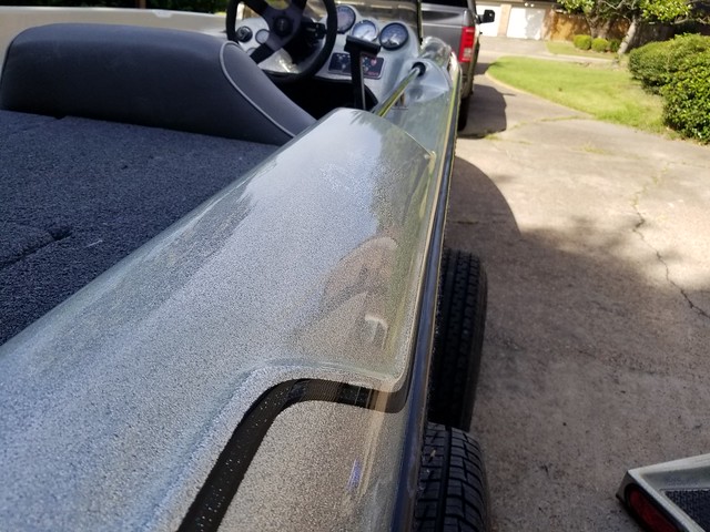

Slowly but surely it’s coming along while I’m saving up for the engine rebuild and a new trailer actuator to come in. Wet sanded, compounded with heavy cut 3M, another ammonia based wash to removed any left over compound. After that I went with the Pro-Tec Nu Paint product, buffed that in and applied their sealer polish. Tomorrow it’ll get another sealer polish coat. Now I to get all my new decals, compartment trim and other goodies. Also the fenders are going through the same process right now, then the wheels will get some real attention.
Doesn’t look quite new, but definitely doesn’t show it’s age anymore. That’s as far and I personally will take the gelcoat down, it has some spots that could use more sanding. Probably take it to a pro next year.
