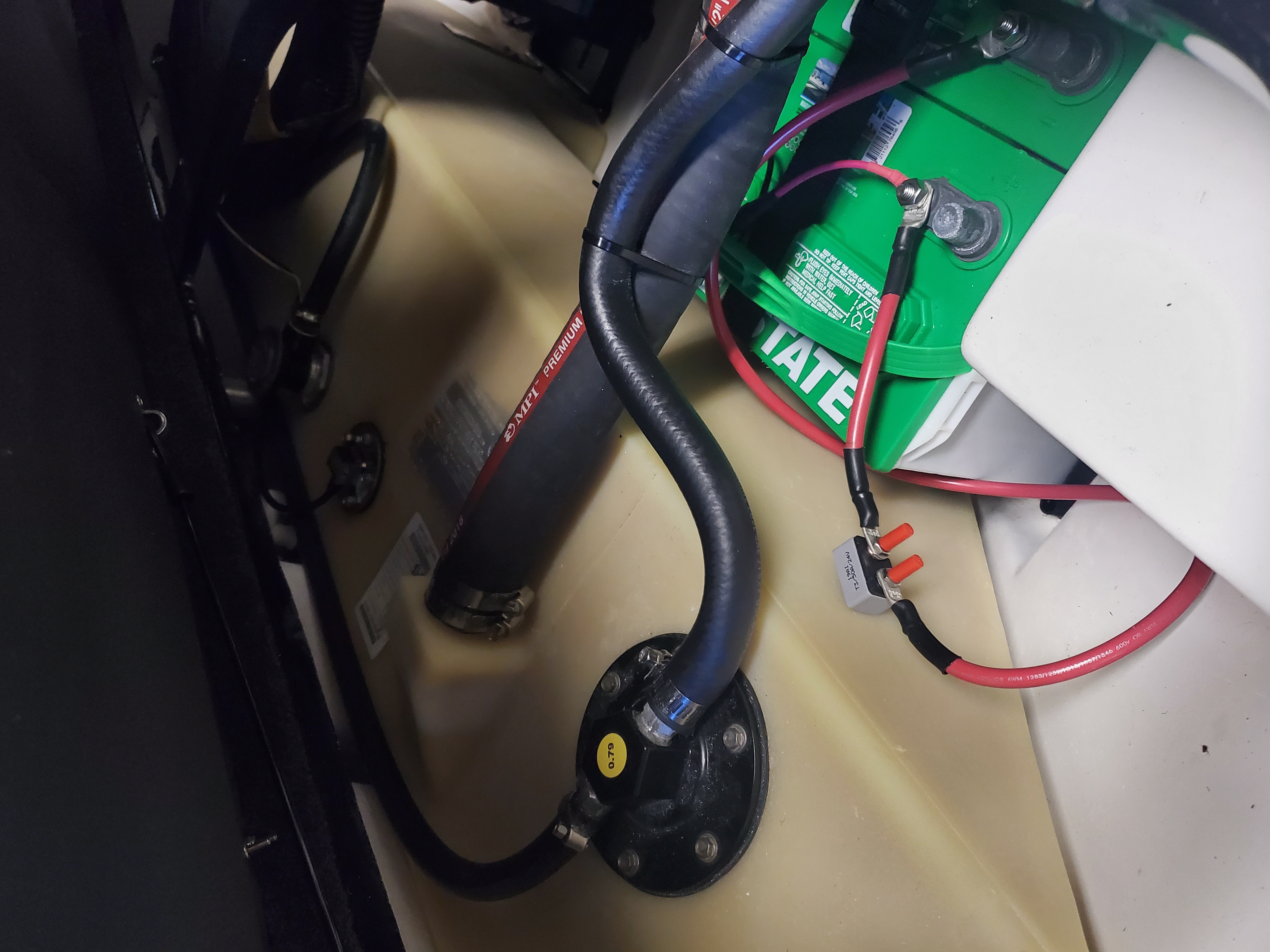

You might be suffering from the same issue my classic had the first year which was really annoying. With mine, the vent hose that came off the tank was zip tied to the inlet fuel hose on the underside. It was almost parallel, if not even a slight drop after it came off the tank, which constantly caused liquid fuel to get in that little dip. This also caused me to not be able to put fuel in because it wasn’t venting during fill up. When I opened the cap, gasoline would go everywhere.
I finally cut the zip ties and routed the vent hose to be zip tied to the top of the fill hose so that essentially there is about 1.5 – 2 inch rise coming out of the tank now which has allowed any liquid to drain back into the tank on its own without getting stuck. Since then, I have had zero issues with filling or any liquid shooting out. Not sure if your issue is that simple, but its a thought maybe?

The above ^ poster is probably on track. This is likely the vent line drooped below the tank top. That is what traps the fuel in the vent line and the pressure then relieves the fuel under air pressure from inside the tank.

Ok looked at my bilge. This is definitely one of my problems. I see how it is routed on the bottom and has a slight dip in it. I’ll fix that and see what if any difference that makes. Thanks for the photo.
After looking this is definitely one of my issues so I will re-route the hose.
