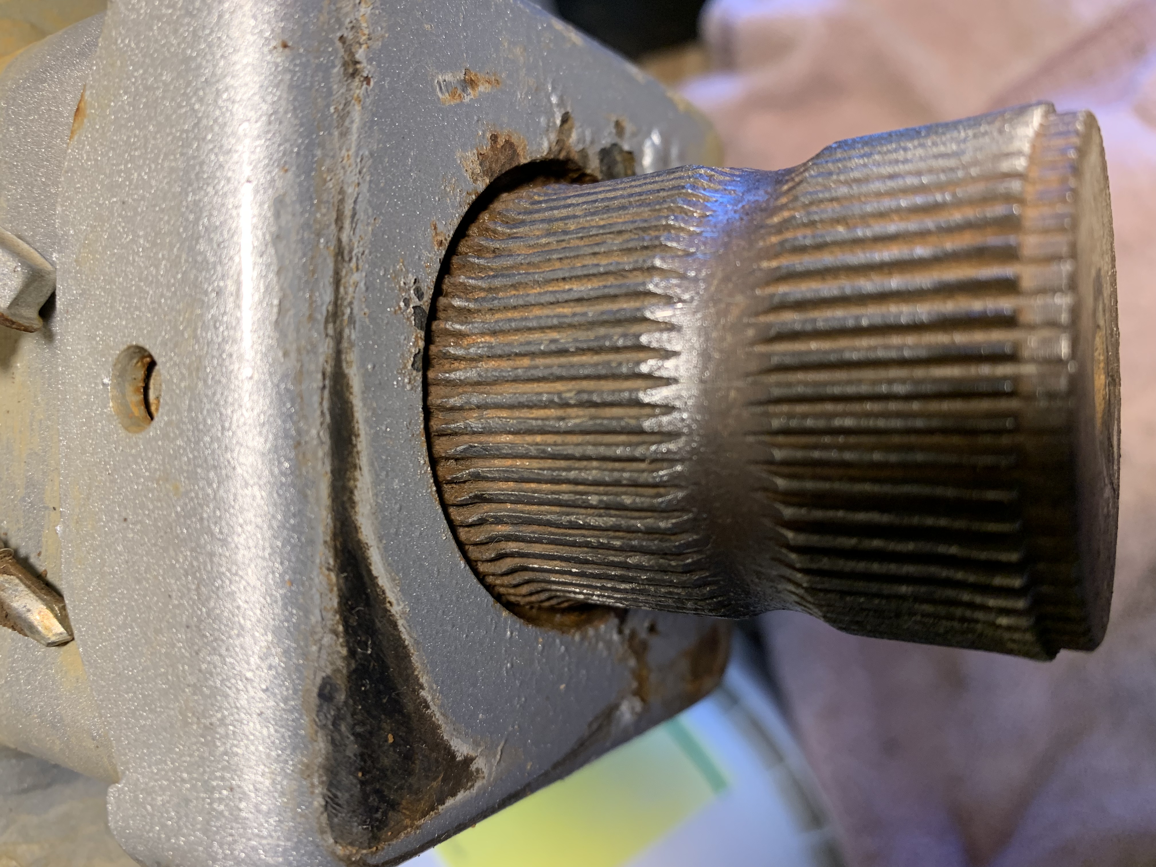

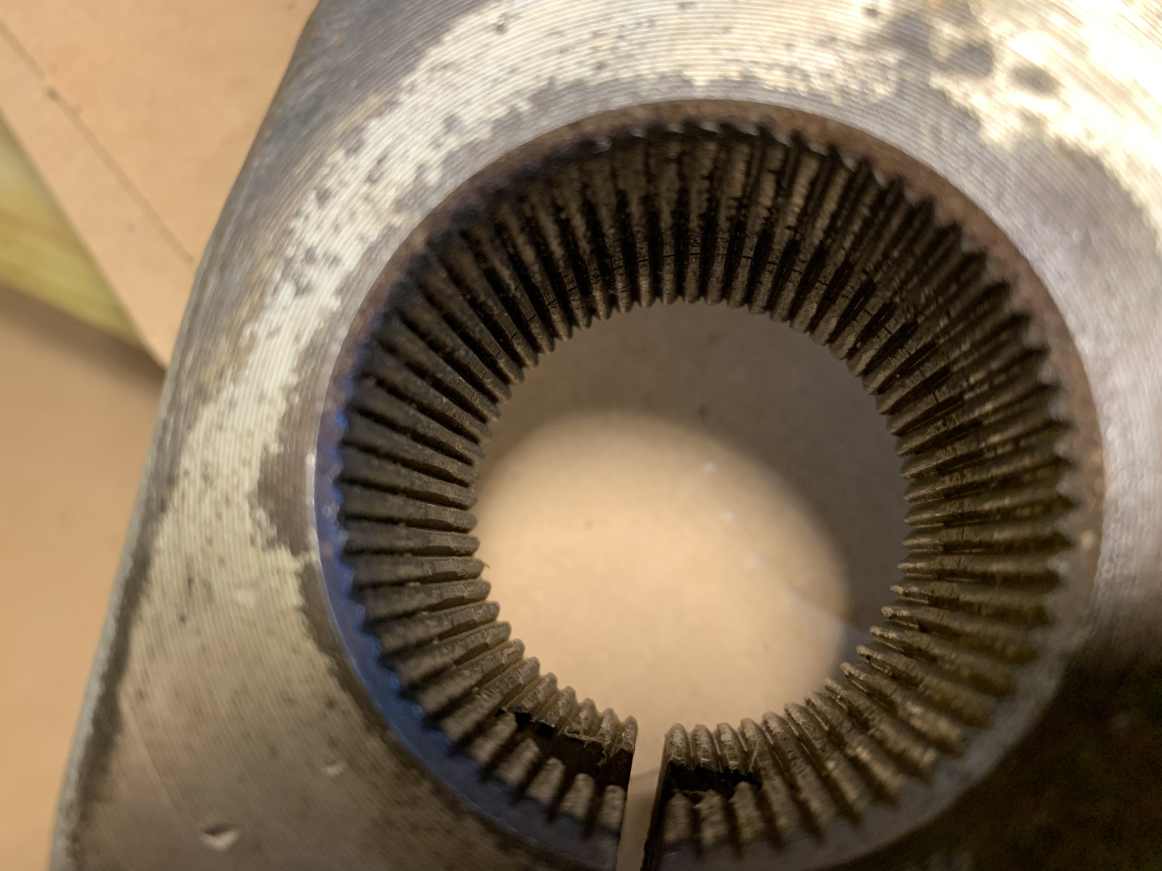

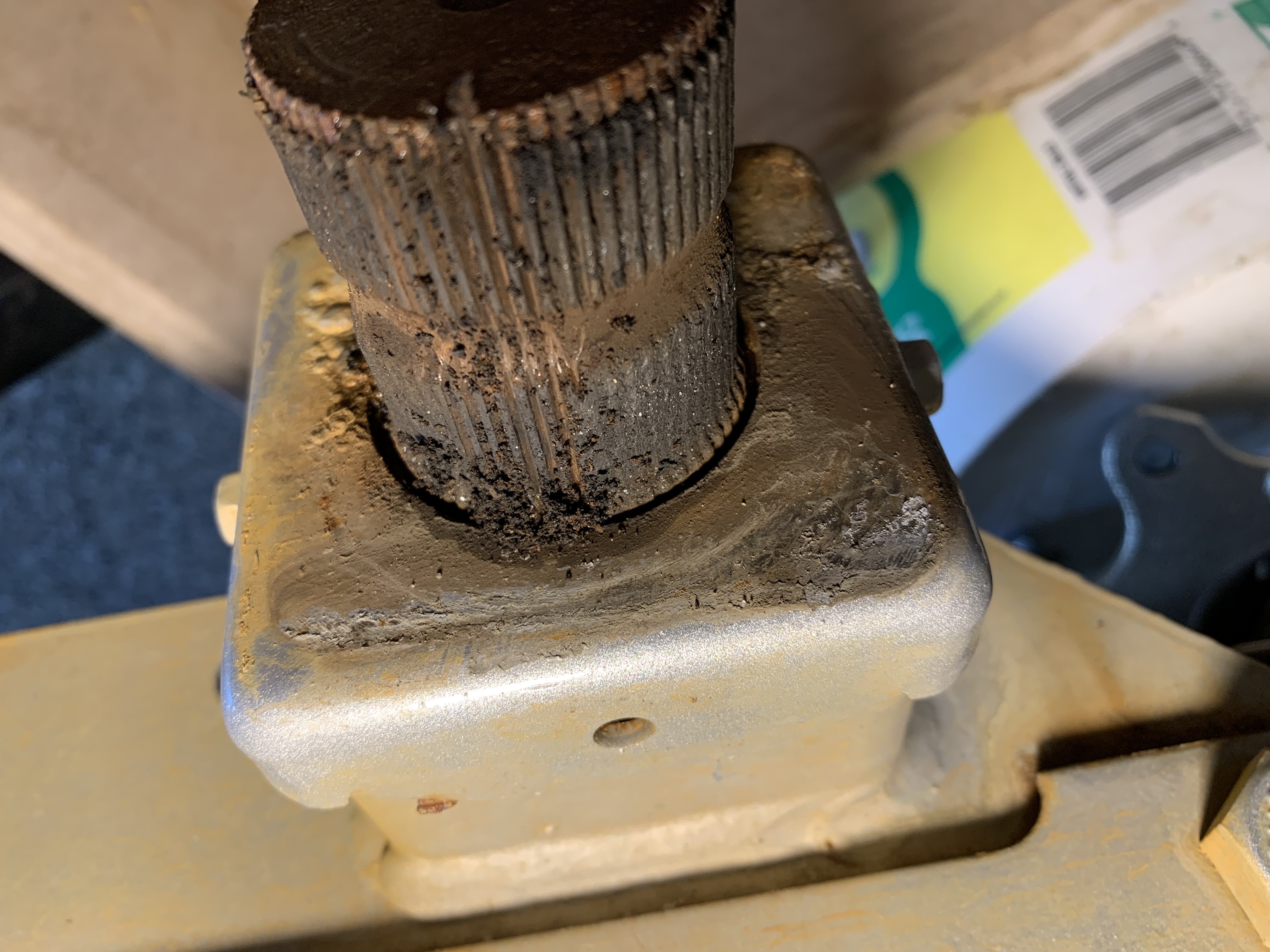

I have a 2013 P2, with a Tandon Trailer (purchased 8/2014) and the splines/teeth on the Torsion Axles and Arms (all 4) are worn causing the Arms to rotate down and the tires to rub on the fenders and bottom out. The pictures show how much the teeth have been worn down, even thought I have checked to maintain 150lb torque on the arms.

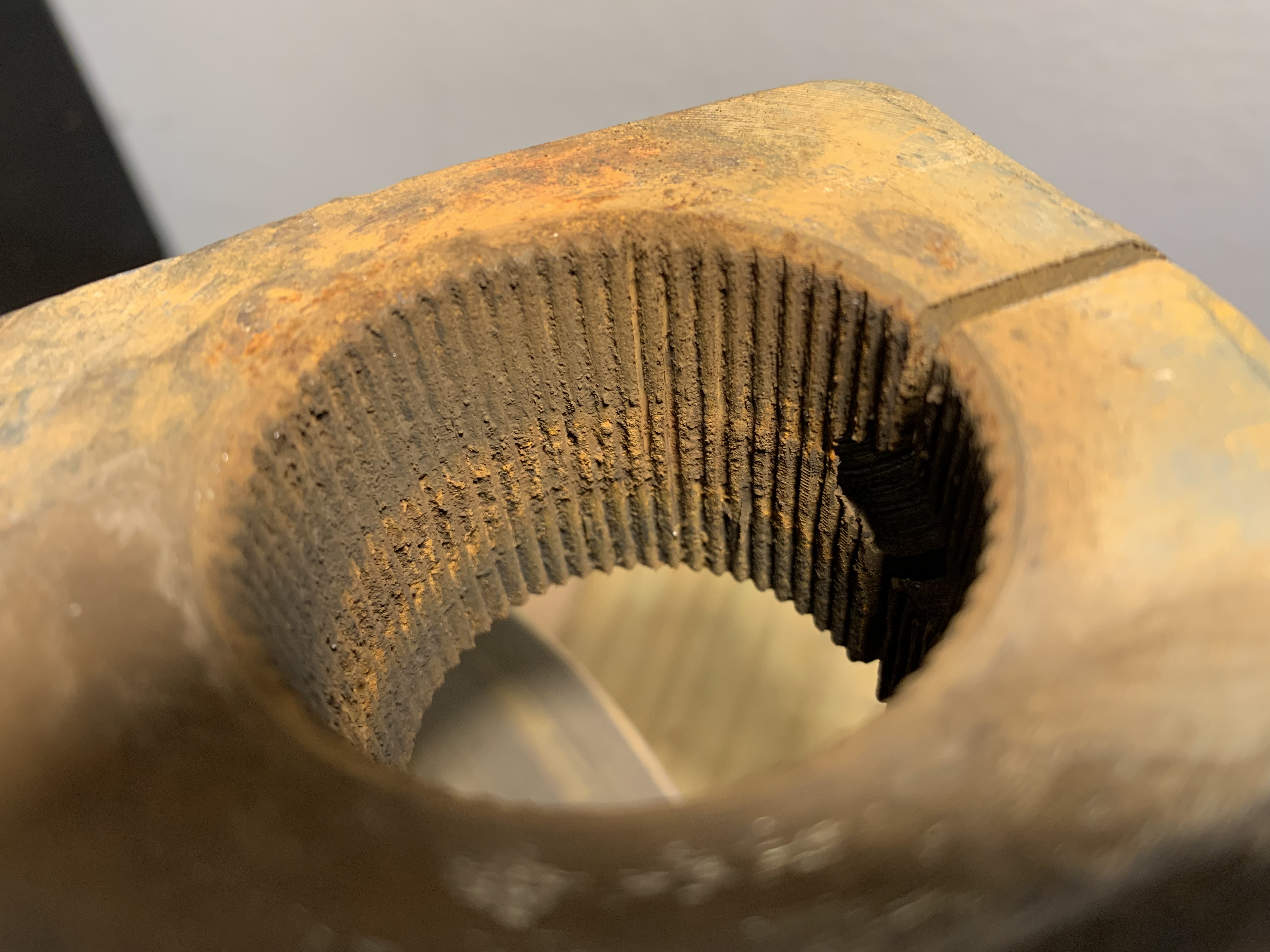

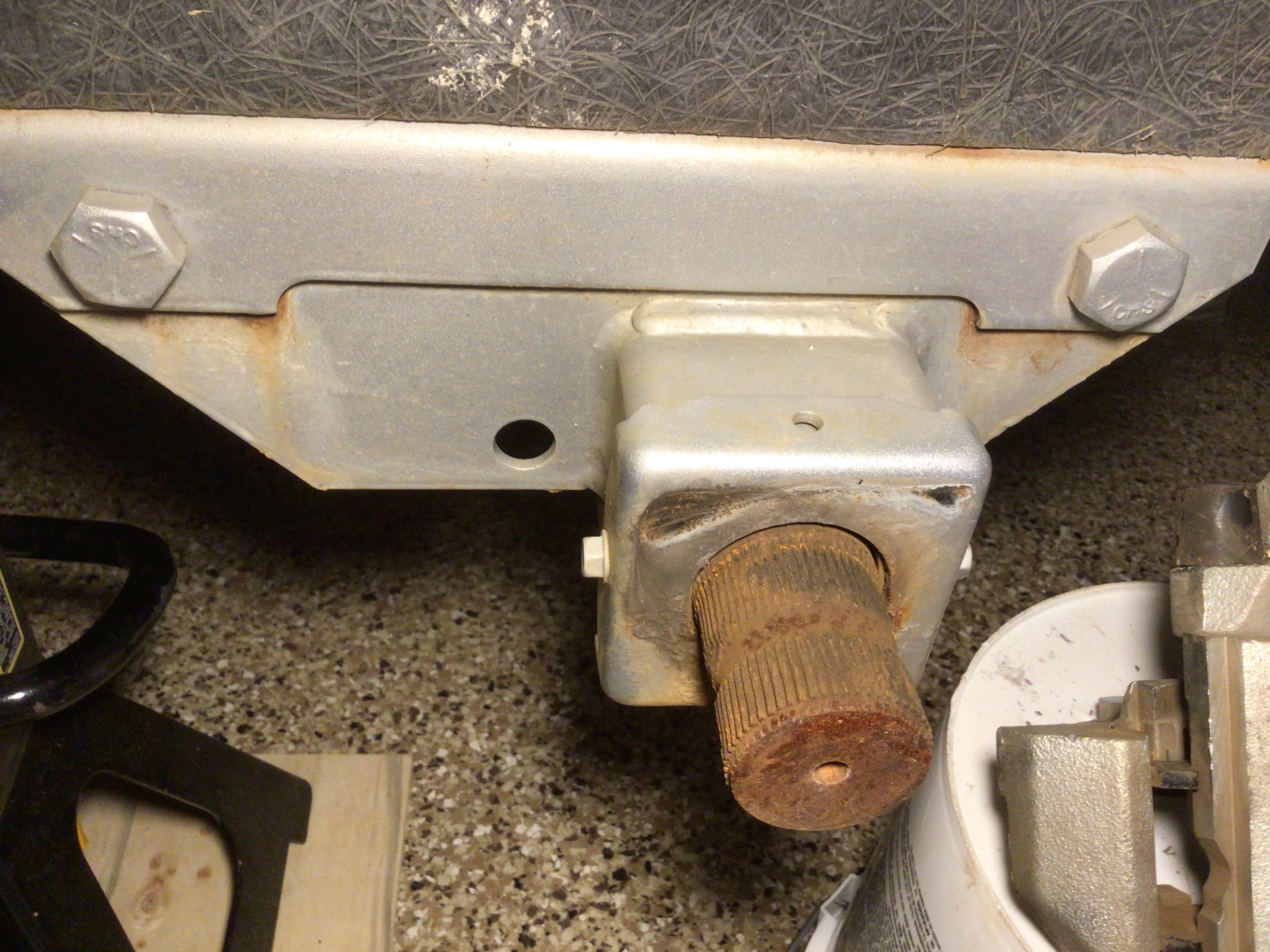

The rusting of both components seems to have contributed to the problem as you can see in the attached photos ( before and after cleaning).
