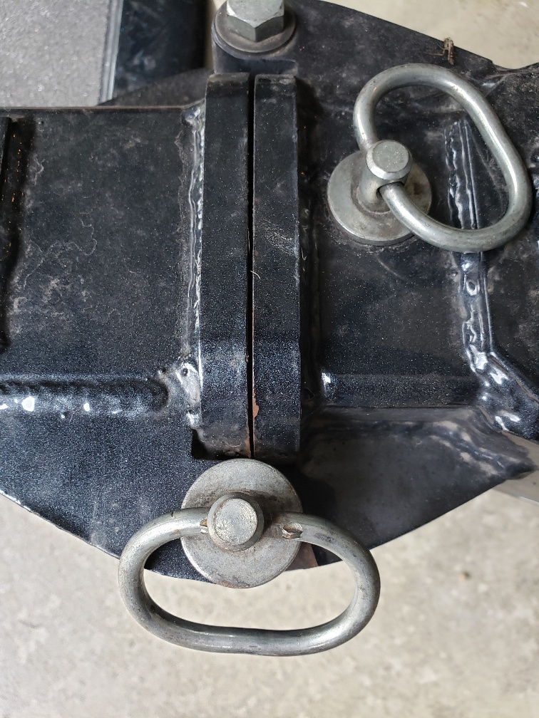

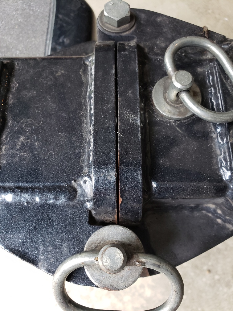

I bought a 2009 Basscat Puma about a month ago and noticed my swing tongue had some slop in it when the strap was loose. The pictures show the gap when the strap is loose. Is this normal or is it something that needs to be looked at?

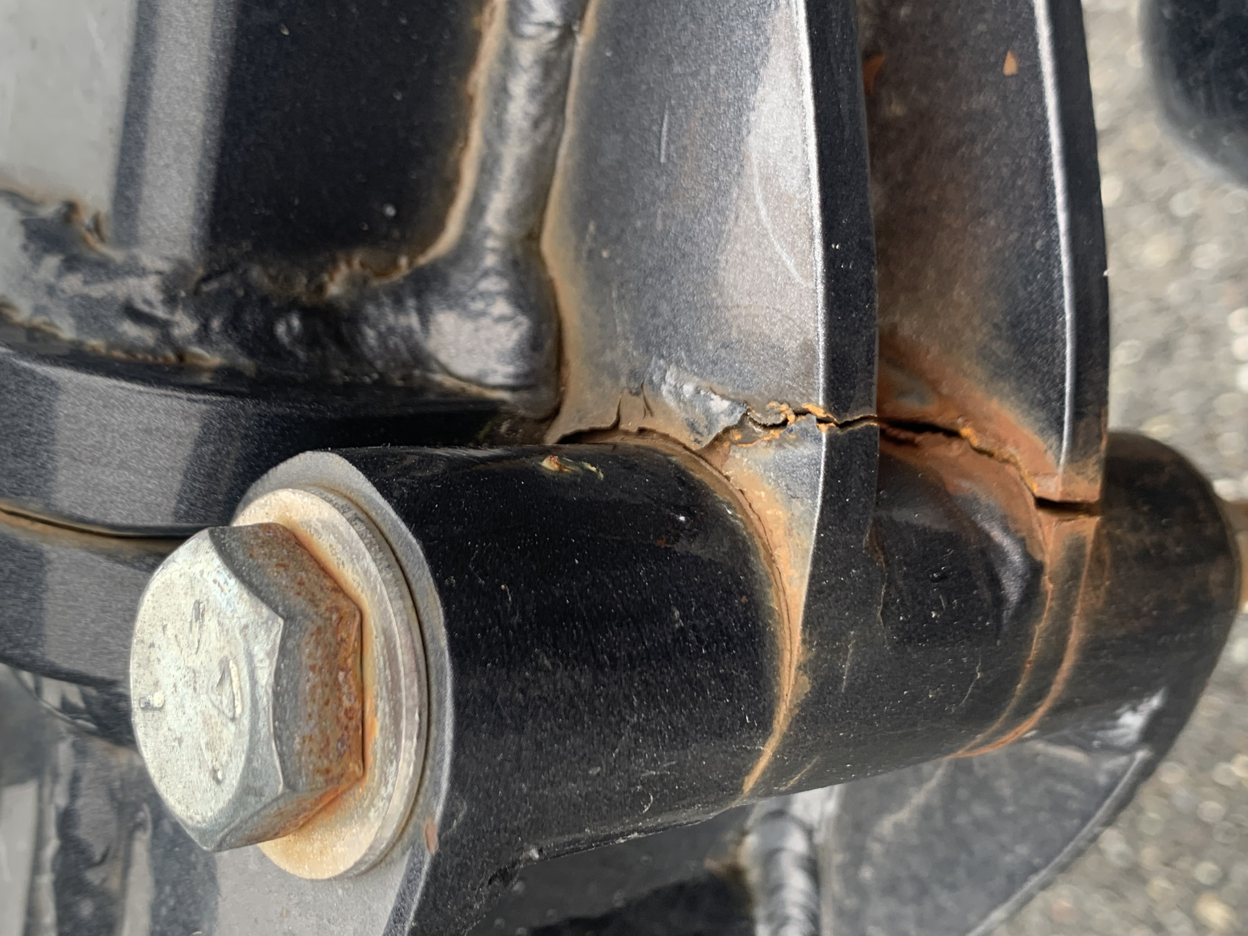

I hate to piggy-back on an old post but I am having the same issue as the above and was wondering whatever came of this post. I have the vertical slack in my swing tongue and I believe this has caused cracks on the bolt side of the connection. I posted about this on BBC but didn’t get any responses. I am worried about only getting this welded but not fixing another issue that may have caused the cracks in the first place. Appreciate any help.
